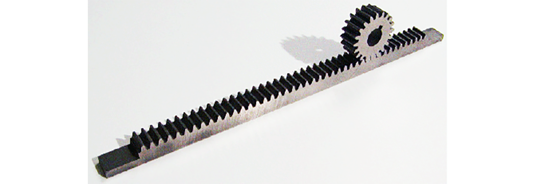

A gear and rack made by the GlobalMAX

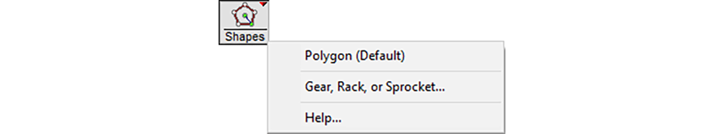

1. Right-click on Shapes on the left side of the screen.
2. Choose Gear, Rack or Sprocket from the drop-down menu.

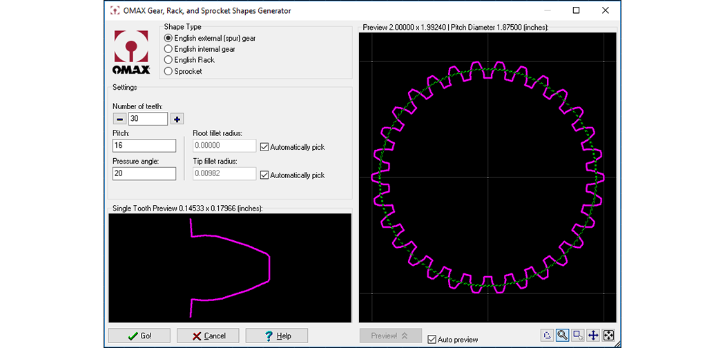

3. The Gear, Rack, and Sprocket Shapes Generator dialog is displayed. Use this dialog to select your Shape Type: English external (spur) gear, English internal gear, English Rack, or Sprocket.
The large preview window on the right shows the gear that will be generated as a result of the current values. Another window shows a view of a single tooth. Zoom in and out in both of these windows by moving the cursor over the window and using the left mouse button to zoom in and the right mouse button to zoom out.

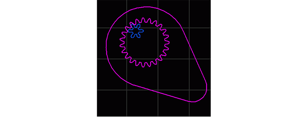

Shape Type

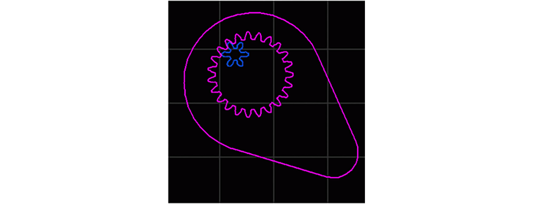

Choose what you want to create. An external gear is a gear designed to mesh on the outside of the circle. An internal gear is designed to mesh inside the circle, and a rack is straight.
The blue gear is an external gear, the purple gear is an internal gear
Number of teeth
Enter the number of teeth in the gear. The + and - buttons may also be used to increase and decrease the number of teeth.
Pitch

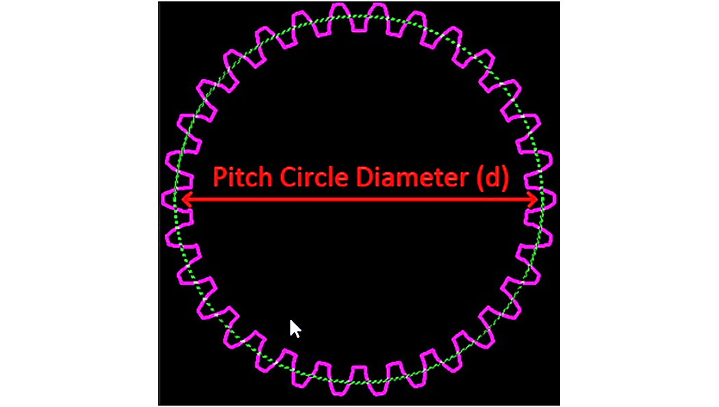

Enter the diametral pitch of the gear. The diametral pitch (P) is a ratio of the number of teeth (N) to the pitch circle diameter (d), P=N/d. The smaller the diametral pitch, the larger the pitch circle diameter, creating a larger gear.
Pitch Circle (green), Pitch Circle Diameter (red)
Pressure Angle

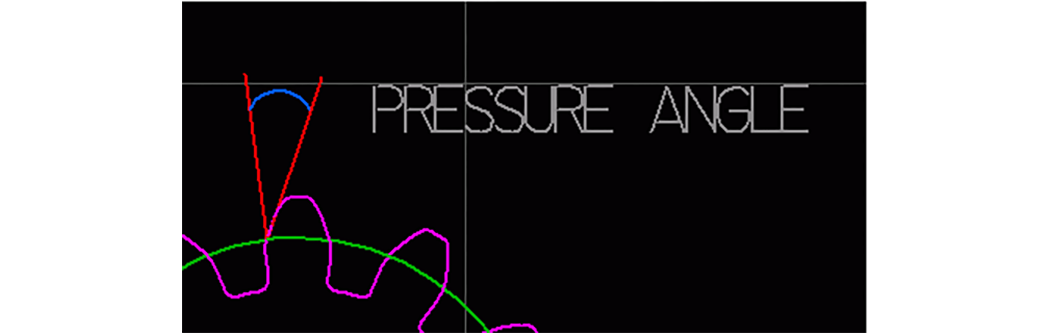

The Pressure Angle is the angle between the gear tooth and a line perpendicular to the pitch circle. (It is the same angle as the angle between the line of action and a line tangent to the pitch circle.)
Root Fillet Radius
Tip Fillet Radius
By default, these are automatically computed. Clear the Automatically Pick check box, and any value can be entered. Note that it is possible to enter values that result in gears that are impossible to make. If you make a gear with many fine teeth, where the root fillet radius is less than 0.0155 inches, then no radius is placed. Instead, the radius of the jet will make the radius in the corner.
When the desired settings are selected for the gear or rack, click Go.

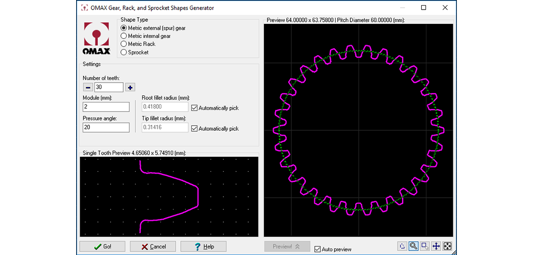

3. The Gear, Rack, and Sprocket Shapes Generator dialog appears. Select Metric External (spur) gear as your Shape Type:
The Gear, Rack, and Sprocket Shapes Generator in Metric units
Number of Teeth

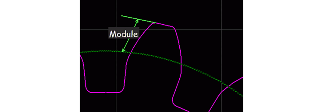

Module
The module is the pitch diameter divided by the number of teeth. It is also the length of the "addendum" (the distance from the tip of the tooth to the pitch circle).
The relationship between the module (M), the number of teeth (N), and the pitch circle diameter (d) is:
d = MN

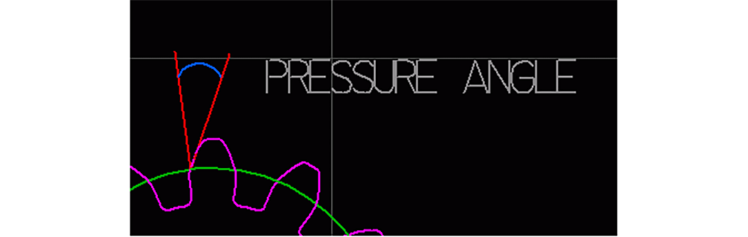

Pressure Angle

By default, these are automatically computed. Clear the Automatically Pick check box, and any value can be entered. Note that it is possible to enter values that result in gears that are impossible to make. If you make a gear with many fine teeth, where the root fillet radius is less than 0.397 mm, then no radius is placed. Instead, the radius of the jet will make the radius in the corner. When the desired settings are selected for the gear or rack, click Go.
The gear (or rack) is placed on the drawing, and is automatically selected to make it easy to move into position.

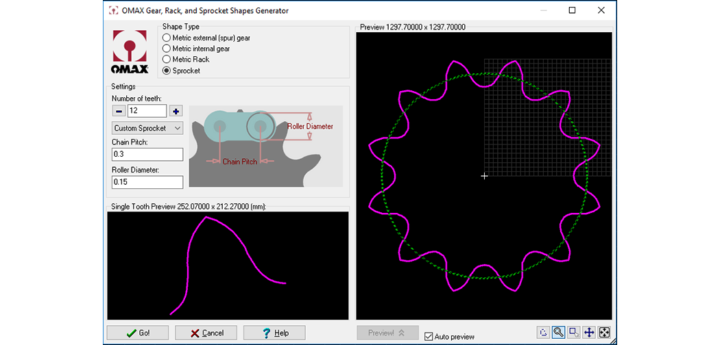

How to Make a Sprocket
1. Right-click on the Shapes button on the left side of the screen.
2. Choose Gear, Rack or Sprocket from the drop-down menu:
3. The Gear, Rack, and Sprocket Shapes Generator dialog is displayed. Use this dialog to select Sprocket as your Shape Type:
The Gear, Rack, and Sprocket Shapes Generator with Sprocket Selected
The large preview window on the right shows the sprocket that will be generated as a result of the values provided. The lower left window shows a view of a single sprocket tooth. You can zoom in and out in both of these windows by moving the cursor over the window and using the left mouse button to zoom in and the right mouse button to zoom out.

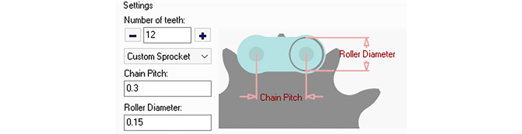

Number of Teeth
Enter the number of teeth in your sprocket. The + and - buttons may also be clicked to increase and decrease the number of teeth.
Custom Sprocket
Use the drop-down menu where "Custom Sprocket" appears as a default and select a predefined sprocket type from the list provided.
Chain Pitch
Measure the chain pitch as illustrated below and then enter that value.
The Chain Pitch and Roller Diameter
Roller Diameter
Measure the roller diameter as illustrated above then enter that value.
When the desired settings appear in the Sprocket generator, click Go.
Your sprocket design is placed on the drawing and automatically selected to make it easy to move into position.
