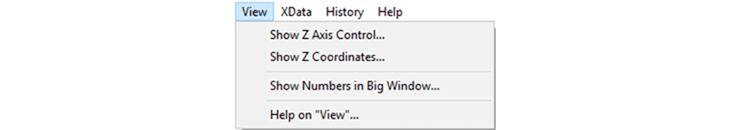

Show Numbers in Big Window
Displays large numbers for the machine head position and progress bar.

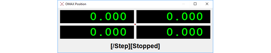

Selecting "Show Numbers in Big Window" displays the machine head position numbers in very large text with a large progress bar underneath. This display is designed to be easily seen at some distance from the controller, making it easier to use a remote control keypad to maneuver the nozzle when standing away from the controller.
NOTE:
You can also press the "+" (plus) key on the main MAKE screen to show these large nozzle position numbers.
When large numbers are turned on, large dialogs are also used for the Move X and Move Y commands. This makes the dialogs easier to see from a distance.
Press "+" (plus) to see these large numbers
NOTE:
While the Path Control is displayed (MAKE is machining a part), you can right-click on the progress bar to bring up a menu that lets you see the large window. You won't be able to use the + key to display the large number window at this point.
To turn off the large number display, either press "+" again, or click on the "X" in the upper right-hand corner of the window.
