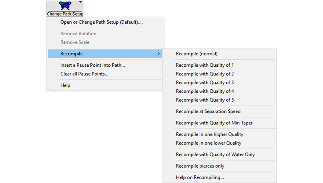

Recompile a part in any Quality
Use the Recompile command to assign all cuts on a part to the same Quality. Traverse lines and lead-in/outs are unaffected, but all other entities are set to the Quality you choose. Use Recompile for quick time studies (to examine the difference between making the part in Quality 3 and Quality 4, for example). It is also useful if to quickly make a part with a different Quality.
NOTE: When “recompiling” in another quality, only the cutting qualities are changed (Qualities 1,2,3,4, and 5). Minimum taper, etches, scribes, water only, and other qualities are kept the same. If you need to make changes other than what is supported by the “recompile” command, use OMAX LAYOUT or a similar program.
1) Right-click on the Change Path Setup button.
2) Move the cursor over the Recompile choice, and another pop-up menu displays.
3) Choose the Quality you want to recompile the part in.
If "Recompile (normal)" is chosen, the part is recompiled with all the original Quality settings.
Select Recompile in one higher Quality or Recompile in one lower Quality to recompile all cutting entities (Qualities 1 through 5) to one quality higher or lower than the qualities selected in the original drawing.

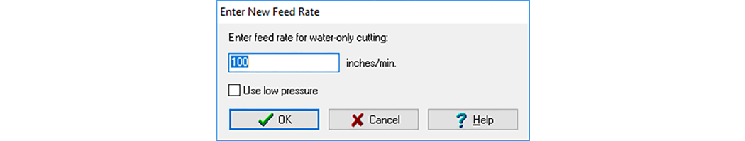

When you recompile with a Quality of Water Only, you are prompted to enter the "feed rate" as shown in the following screen.
You need to specify a feed rate when you recompile for a Quality of Water Only
The feed rate is the constant speed you want the nozzle to move at along your tool path. The speed of the nozzle will not be adjusted for the geometry of your part. This feature is useful when working with very thin or soft materials that can be easily pierced with just water.
You can also choose whether or not you want to use low pressure for Water Only cutting. Again, this is useful when working with very soft or thin materials.
