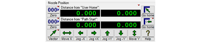

The nozzle position controls move the nozzle and display its current position
The upper right portion of the MAKE window contains the Nozzle Position controls. These controls move the machining nozzle, and also display its current position. The nozzle’s position is displayed relative to its "home" position, a coordinate you can set.
The Nozzle Position controls
Go Home
Moves the machining head to a preset position.
Zero User Home
Sets the user home to be the current nozzle position.
Vector Move
Use the Vector control button to move the abrasive jet nozzle by specifying a distance and direction for the movement.
Move X
Moves the nozzle in a left-right direction by a specified amount.
Move Y
Moves the nozzle up or down by a specified distance.
Jog Left
Moves the nozzle to the left.
Jog+X
Moves the nozzle to the right.
Jog+Y
Moves the nozzle up (away from the front).
Jog-Y
Moves the nozzle down (toward the front).
