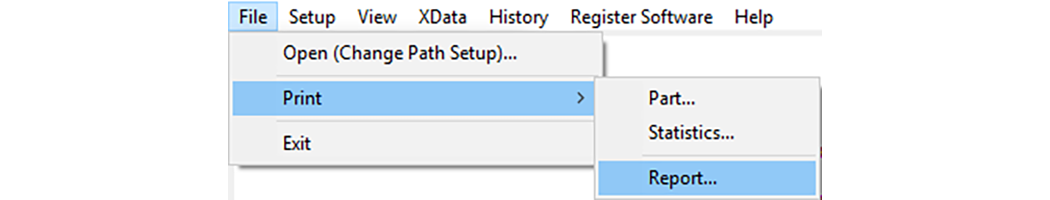

The Report choice from the Print command lets you print out a report using a template. The templates can be customized and used for purposes such as documenting the production of a part, or to quickly generate a custom quote for a part.
NOTE:
This feature is only available if you have a registered version of the MAKE software. See Enter Passwords & Register Software for details on registering MAKE.
Using the Report command is straightforward--you will run the report chosen by the Pick Report Template. Customizing the report template takes some knowledge of formatting for the format you want to use.

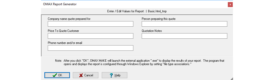

Note that some reports may ask for you to enter information for the report. These values are "remembered" from the last time you ran this report. The information asked for depends on the report designer.
This report asks for values to be entered

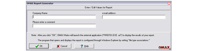

You can create your own variables that ask for input and then display (or manipulate) that input in the report. The values that are entered for the report are "remembered" the next time the report is run, so these can be used for persistent variables as well. This is particularly useful when the report format isn't easily edited, such as HTML files.
The general format of input variables is:
[OMAX_AskFor_<value>]
Where <value> is the prompt you want to appear on the form that appears to the user. The use of spaces in <value> should be avoided; instead, use the underscore ( _ ), which will be replaced with spaces when displayed. Be sure to close the variable with a closing bracket ( ] ).
For example:
[OMAX_AskFor_Company_Name]
[OMAX_AskFor_e-mail_address:]
[OMAX_AskFor_Please_enter_a_comment]
These will display as shown in the following figure:
Three input variables are specified for this report

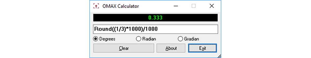

You can use the "Round" function to round to any number of significant digits, as shown in the following example:QuickEval(Round(MyNumberToRound*10)/10)
…where you substitute "MyNumber" with the expression you wish to round. In the above case, one digit will be displayed after the decimal point. To display 2 digits, replace the number "10" with "100", or use "1000" to display 3 digits, etc. For example, to round the number "1/3", which is normally "0.3333333…." to only 3 digits, use:
QuickEval(Round((1/3)*1000)/1000)
You can test your expressions using OMAX Calculator, as shown in this example:
NOTE:
The QuickEval function is based on the same engine that drives the OMAX Calculator and other math expression evaluations in the OMAX software. Because of this, any of the functions these other features support (Sin, Cosine, Max(A;B), Min(A;B), FromINI(), Round() etc.) are available. For a complete list of supported functions, type "Math Functions" into the Index of the OMAX Interactive Reference.

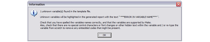

Problem: Variable error message when report is run:
Solution: If the Report Generator doesn't recognize a variable in your report template, you'll get an error message like the above. In the report itself, the location of the error will be marked with the error message text. First check that the name is exactly correct (see List of all variables for a list). If the name is correct, then delete the variable name and retype it. The problem can be because the variable name as been formatted, and is no longer stored correctly in the file. Particularly in RTF file formats, any font changing or formatting inside the variable name will change how the variable is stored and it won't work correctly. You can bold the entire variable name and it will work correctly.
The easiest way to fix this is to simply retype the entire variable name.
NOTE:
Some older HTML editors will substitute %20 for spaces in variable names. If you are using one of these editors, you should use the underscore (_) character in your variable names to avoid problems. Most modern HTML editors do not have this problem. For best results and the least troubles, always use the underscore character (_) for spaces.
