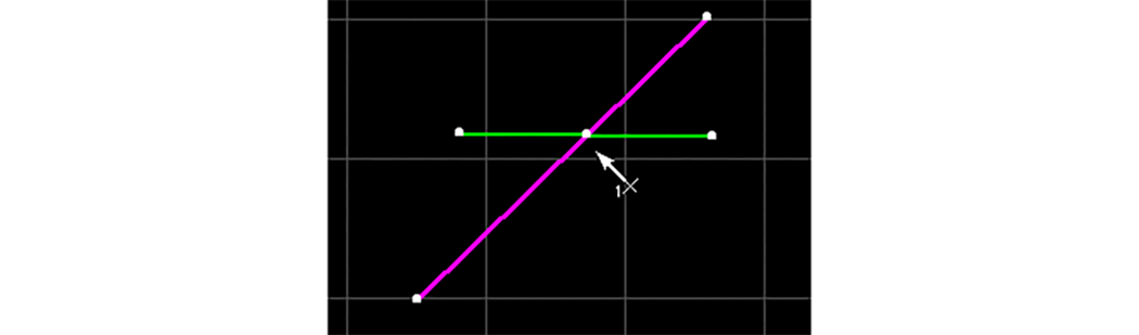

Divide at Nearest Intersection
The "Divide at nearest intersection" command finds the closest intersection of a chosen entity and divides both the chosen entity and the entity it intersects with at the intersection point.
Both the purple and green lines were divided at their intersection
After choosing "Divide at nearest intersection," click the entity to be divided at the intersection. If the entity has more than one intersection, the closest one is chosen - be careful where you click.
