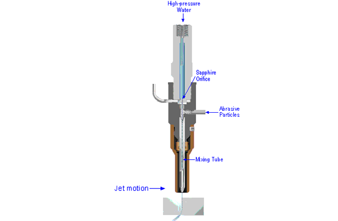

The Quality directly affects how quickly the abrasive jet head moves when it makes a piece. The slower the abrasive jet head moves, the higher the Quality. At the highest Quality (a Quality of 5), the abrasive jet head moves most slowly.
This figure shows how the abrasive jet stream curves as it moves through the material.

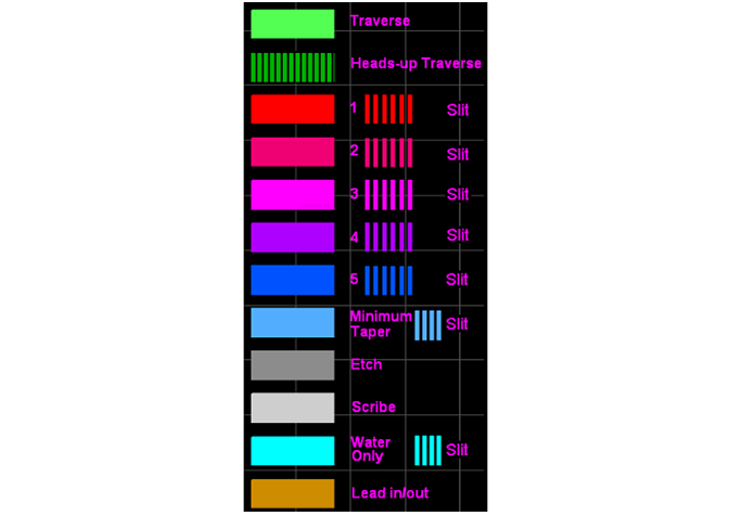

Most of the time, Quality is assigned to entities in a drawing using the Quality command in LAYOUT. Each type quality is color-coded, from red for Quality 1 to blue for Quality 5.
The Quality colors (T = Traverse; E = Etch; S = Scribe; H = Water Only; L = Lead in/out)

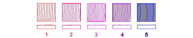

Qualities 1 through 5 use abrasive and water to pierce the material. A Quality of 1 will pierce all the way through a material. Because the abrasive jet head is moving quickly, however, the surface finish obtained with a Quality of 1 is rougher than that obtained with a Quality of 5 (which is a smooth finish).
Most high tolerance parts are cut at a Quality of 3, as this provides a good balance between machining speed, surface finish, and precision.

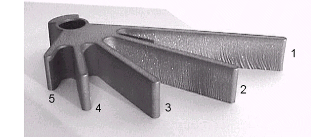

Notice also that as the Quality numbers get lower, the surface finish gets rougher.

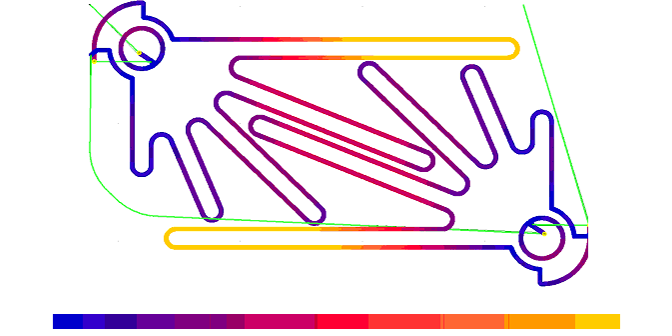

Each leg of this part was made at a different Quality and required the same amount of time to cut
Blue (Slowest cutting speed) Yellow (Fastest Speed)
The different speeds for each Quality, shown graphically
