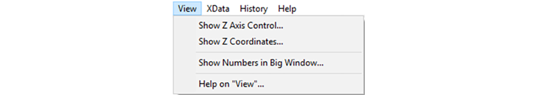

Displays large numbers for the machine head position and progress bar.

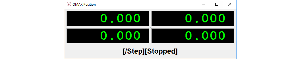

Selecting "Show Numbers in Big Window" displays the machine head position numbers in very large text with a large progress bar underneath. This display is designed to be easily seen at some distance from the controller, making it easier to use a remote control keypad to maneuver the nozzle when standing away from the controller.
You can also press the "+" (plus) key on the main MAKE screen to show these large nozzle position numbers.
When large numbers are turned on, large dialogs are also used for the Move X and Move Y commands. This makes the dialogs easier to see from a distance.
Press "+" (plus) to see these large numbers
While the Path Control is displayed (MAKE is machining a part), you can right-click on the progress bar to bring up a menu that lets you see the large window. You won't be able to use the + key to display the large number window at this point.
To turn off the large number display, either press "+" again, or click on the "X" in the upper right-hand corner of the window.
