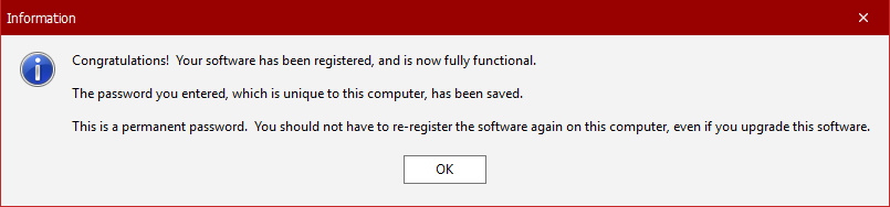

10. In Step 3, click Done.
11. A message confirms that the software is registered. Click OK to complete the process.
