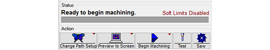

The machining controls are on the right center of the MAKE window.
There are five buttons:
Change Path Setup
Loads a new part, or changes the type and thickness of material.
Preview to Screen
Simulates how the abrasive jet head will make the part.
Begin Machining
Begins making the part.
Test
Tests the nozzle's water and abrasive flow.
Saw
Operates the GlobalMAX as a simple cut-off saw.
