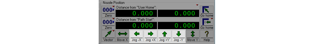

1. Use the numeric keypad to move the nozzle to the proximity of the hard stops. ClosedThese are usually located at the lower left corner of the machine, near where the operator would stand when at the controller.
2. Move the Y-bridge away from the X-rail hard stops (5–12 in. [127–304.8 mm]).
3. Z-axis accessories may require that components (such as the nozzle, mixing tube, terrain follower, or other parts) be removed or adjusted.
4. Move the nozzle so that it is 5–12 in. (127–304.8 mm) from the hard stops.

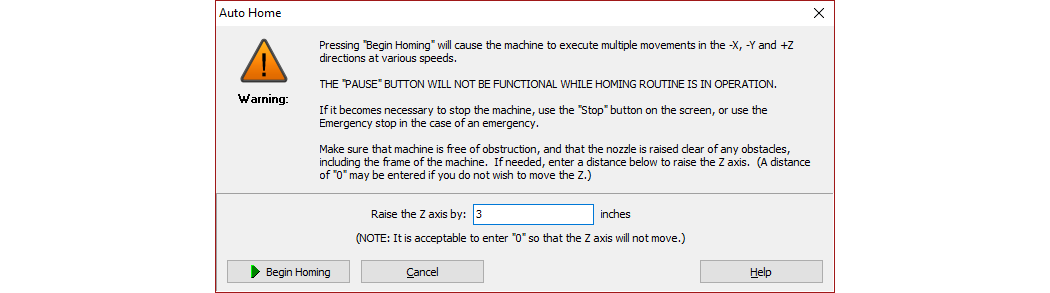

1. To enable cutting, at the top of the screen click Machine needs to be homed. Click here to home the machine.
2. In the Raise the Z-axis by box, enter the distance to move the Z-axis up so that it clears any obstacles or machine edges. If the Z-axis does not need to be raised, enter 0 (zero). The maximum amount is 5 in. (127 mm). Begin Homing becomes available.

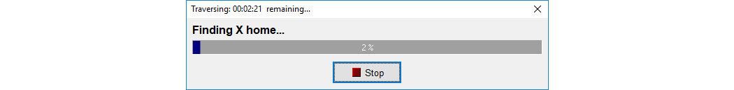

3. To start the automatic homing process, click Begin Homing.

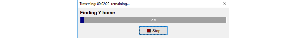

Z Height moves to the distance specified. The Traversing window counts down the time remaining to find X home.
After the time limit is reached, MAKE automatically starts finding the Y-axis hard stop.
Note: Only press Stop during an emergency or if there is an unexpected nozzle collision. Pressing Stop while the machine is finding X and Y homes cancels the operation, and the homing process will need to be restarted.

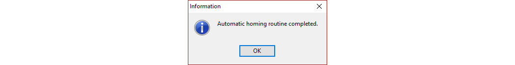

4. When the automatic homing routine is complete, click OK.
