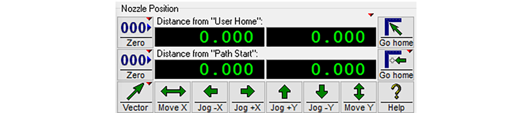

User Home
The "User Home" is always displayed at the top of the Nozzle Position panel (see picture below).
The position of the nozzle relative to the User Home is always displayed on the top line. This is used as a "scratch pad" to remember a spot on the machine temporarily, so you can get back to it. For example, say the nozzle has already been moved into position, and you suddenly remember that you need to do a "Test Pump." Click on the "Zero" button for the user home, then move the machine off of the material, do the "test pump," and then click on the Go Home button for the user home. There is no need to find the starting point for the path again, because it was stored in the user home.

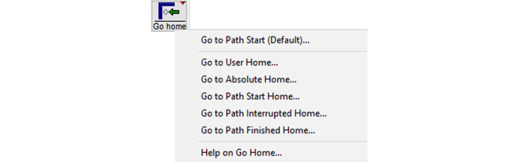

To Go to a Home
To go to a home that is displayed, click the Go Home button to the right of the display.
You may also right-click on the Go Home button to choose a home from the pop-up menu. Note that not all homes are available on this menu.
Right click on the Go Home button to get a list of homes you can go to

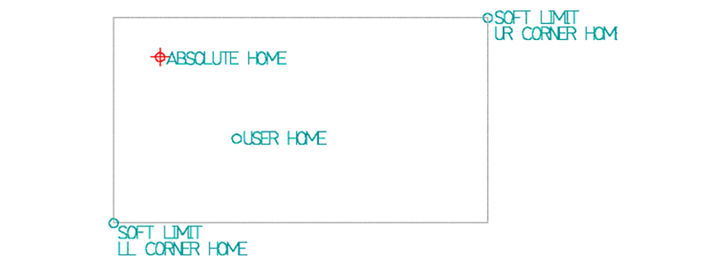

Some typical home locations on the machine, and where they might be placed.
Notice how the soft limit homes define the two corners of a box.

Absolute Home Limits
Absolute Home Limits define the physical movement of the X-axis and Y-axis on the machine. These are hardware limits that are set using physical stops installed on the ends of the X- and Y-axis rail assemblies (Y=0, X=0 points). While possible, the cutting head is rarely set to reach these absolute limits because it could crash into the side of the table, causing serious equipment damage.
Soft Limit LL Corner
The Soft Limit LL Corner home stores the lower left (LL) limit of motion for the nozzle. If soft limits are enabled, then the machine will not move to the left, or below this spot. If soft limits are not enabled, then this position is not used.
By storing the soft limits as "home positions," they can be automatically restored by rezeroing the Absolute Home.
To set the soft limits, use the commands under the "setup" menu. See Soft Limits for more information on setting soft limits.
Soft Limit UR Corner
The Soft Limit UR Corner is similar to Soft Limit LL Corner, except that this home stores the upper right (UR) limit of motion for the nozzle.
